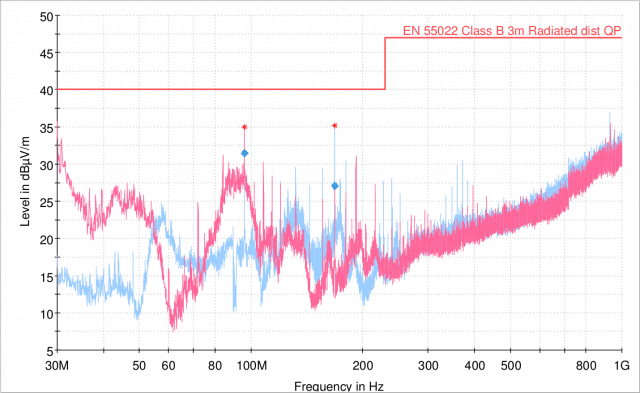

We've been visiting the EMC lab of TÜV since our first successful test. The reason is twofold. First, we wanted to improve on the results, and second, there were some further tests to be done.
The testing results that we shared with you the last time already passed, but the safety margin was only 2 dbμV/m, instead of the recommended 5 dbμV/m. Our worry was that the margin was so thin that it was possible for the final test to fail. We really wanted to avoid any potential failure, so we have been tweaking various resistor and capacitor values, and have been trying various bridge cables and USB cables to make the margin wider.
You know what made a drastic difference? The USB cable. As soon as we tried a USB cable with a ferrite choke on the keyboard end, the EMC graph changed very substantially. Don't worry, this ferrite choke is only 24 mm x 14 mm in size, and it's very light so it doesn't weigh down the cable.
The updated EMC graph
According to this graph, we went from a 2 dbμV/m safety margin to about 18 dbμV/m! (See the vertical distance between the blue mark around 100M and the red line.) Given these results, we'd be extremely surprised not to pass the final test.

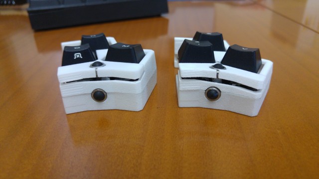

At last, I'm happy to show you the first version of the 3D printed modules:
These prototypes were printed using a white, powder-like material, but the final modules will be offered in black color.

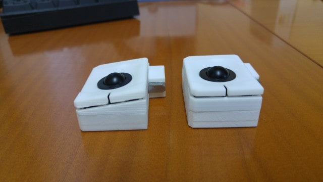

Originally, we created two versions of the modules, one of them being totally flat, the other one being angled.
Flat key cluster module on the left, angled key cluster module on the right

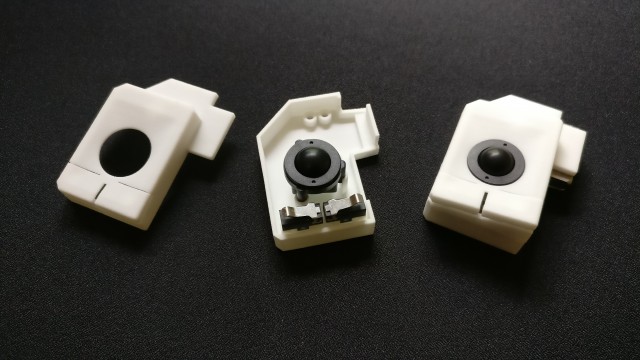

We've been experimenting with a front and a top mini trackball on the key cluster module, but concluded that the top one is much more usable, so we'll ditch the front-sided mini trackball.
Angled trackball module on the left, flat trackball module on the right
The trackball module from the inside without the PCB
The reason we've made two versions is to test them and see which version is more ergonomic. The flat modules made our thumbs stretch significantly less, so we're confident that they're a better choice. This is also very fortunate from a manufacturing standpoint as the space inside of the modules is very limited, and even more so in their angled versions, so the flat versions will be easier to design and manufacture.
We also found that it's not a good idea to use two buttons per module because the inner button which is closer to the UHK usually gets pressed when pressing the case button of the UHK. Our plan is to only feature a single button per module, the outer button that is farther from the case button of the UHK.
This is a big step forward, but there's still a lot to do in the future. These plastic cases don't contain PCBs yet, so they will have to be designed. Luckily, the left keyboard half is an module from an electrical, firmware, and protocol standpoint, so we will be able to reuse its schematic and firmware. These plastic cases of the modules are only made for mechanical testing purposes and need to be redesigned here and there because they are not manufacturable, and lack structural support.

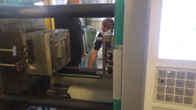

Molding plastic parts
I'm a software developer by trade, so I have little knowledge about injection molding. A couple days earlier however, I was fortunate enough to observe the process up close in an injection molding facility where we tested our molds.
The mold of the top right case
As so many things, injection molding looks deceptively simple. Plastic flows into a mold, and the perfect plastic part falls out of the machine. Just like on this video:
In practice, lot of things can make a plastic part less than perfect, such as warping, which is the major issue we have mostly fixed.
You see, warping is a very common phenomenon, and it's usually so slight it doesn't matter. In our case however, it does. As it turns out, of all the keyboards ever created, the UHK is probably the most sensitive to warping. This is because when the plastic cases of the two keyboard halves are merged, it becomes extremely pronounced.
When the UHK is merged and the halves warp even slightly, a very slight V shape can be noticed. This shape raises the four outer legs while the four inner legs firmly touch the ground which is obviously unacceptable.
Surface finish issues, such as sink marks and surface defects are another category of injection molding issues we have to deal with which we have also mostly fixed.
One way to fix the above issues is to tweak various mold and injection parameters which we were actively pursuing quite successfully during our three-day stay at the factory. It's mind-boggling how many parameters can be tweaked, such as the injection speed, pressure, after-pressure, mold temperature, the duration of the molding process, and many more. To make things even more complicated, these parameters are not single numeric values but rather graphs, and multiple points of the graph can be set along the time axis!
The other way to fix these issues is to modify the molds themselves. This is usually more time consuming and involves machining the molds in various ways. Some of our issues can only be solved this way.
We have a rough schedule in place regarding the plastic parts:
  1. Within days, the injection-molded cases will be scanned with a 3D laser scanner to reveal the inaccuracies for the molds to be fixed.
  2. In the next week, the left and right bottom molds will be fixed according to the above results.
  3. Another week later, we'll mass-produce the bottom parts for the pilot run.
  4. Within a month, we'll get all the molds fixed, fine-tune technological parameters, and manufacture every plastic part for the pilot run.

Please note that the we don’t provide a backlit UHK yet, but the prototype exists
The measurements taken by TÜV are of considerably higher resolution than those at T-Network, and they do take proportionally more time. Instead of taking around 3 minutes, they take about 15 minutes each. This time, we passed the test! You can see the result below.
EMC measurement
This may look like a fail, but it's not! There are two peaks that are above the safety zone, but as it turns out, there are two measurements involved. In the first measurement, the peaks get detected. In the second, the peaks are more closely investigated which usually results in considerably lower values. The final values are marked with blue rectangles below the peaks, and they're all within the safety zone.
This is clearly a much better result than anything we’ve ever measured, although admittedly, the safety margin is quite tight around 84 Mhz. Endre has an idea how to make it even better by replacing some components, and we’ll test his idea in a week, but we’ve already booked a certification date for June regardless.
We’ll send two final prototypes to TÜV Hungary by the end of May, who will in turn forward the prototypes to TÜV Netherlands where the actual certification will take place. The certification itself is expected to take 4-5 weeks. This is longer than anticipated and the PCBs can only be mass produced after the certification succeeds. Unfortunately, this pushes delivery to July.

We’re about to use the mold with a more capable injection molding machine, which may make these sink marks disappear. If not, we’ll modify the mold further.

EMC testing
EMC stands for electromagnetic compatibility, and such tests basically make sure that electronic devices do not interfere with each other. Because, believe it or not, people expect their phones to work when the microwave is on. You get the idea.
The UHK is no microwave, but in order to be allowed to be sold worldwide, we have to stick FCC and CE logos onto its back. And in order to be entitled to use these logos, the UHK must pass standard EMC tests.
This made us visit the EMC lab of T-Network to measure the electromagnetic emission of the latest UHK prototype. T-Network is a logical first step because their measurements are fairly affordable unlike the final measurements and certification at TÜV which is an order of magnitude more expensive. We better get this right because if not, we’ll have to pay big bucks to TÜV upon every subsequent try.
After walking into their building, making a few turns, and finding the right door of the long corridor, it wasn’t hard to notice that we arrived to the right place.
When opening the inner door of the lab, the SAR, or semianechoic room gets revealed. This is where the actual measurements take place.
In this setup, the UHK is plugged into a laptop and sits on a table, measured by the scary bigass antenna in the corner. Let’s take a closer look at it.
On this image, the antenna is oriented horizontally, and it stands in its lowest position, but it can rise way, way up.
During a measurement session, the antenna rises 4 meters upwards, then rotates its head vertically, and also does measurements that way. The result of the measurement is a graph.
This one has failed
The goal is to stay below the red line which we only achieved once out of 15 measurements: when the UHK was powered from a USB power bank, and hence it only received power and USB communication was inactive.
Success!
So according to the measurements, we have a good reason to believe that the USB circuitry of the PCB is not routed optimally. Even though I couldn’t foresee this, it’s not all that surprising because I routed the PCB using some external help, and I’m not an electrical engineer.
I’ve been told that failing the first test is pretty usual, and we shouldn’t be overly worried. In any case, it’s apparent that the time has come for me to resign as a self-taught PCB designer, and hand over the redesign of the PCB to a professional. As a matter of fact, I may have already found the right person. More on him in the next update.
As a last word of this section, I’d like to sincerely thank Robi for helping so much in the lab. His help was critical to figure out the exact problem.
