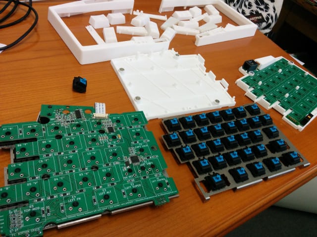

A couple of years ago, I was completely new to electronics and never soldered a thing in my life. Fast forward to the previous week, I was soldering the 5th generation prototypes of the Ultimate Hacking Keyboard. It's been quite a journey and although I am by no means perfect at this stuff, upon reflecting on it I realized that I was able to push my PCB assembly productivity to the next level several times in a row, so let me show you what I learned.

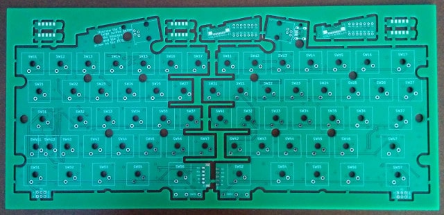

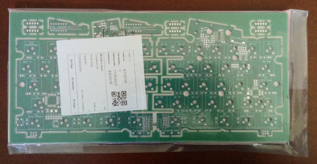

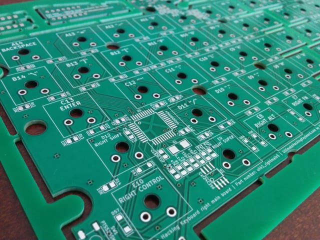

Given that you asked for panels from the fab everything starts with depanelization. Even though this is a no brainer and doesn't require any skills or equipment other than a flash cutter, I decided to show it because I'm sure a lot of people have never seen it in action.

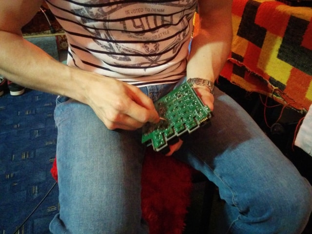

Next up, PCB assembly follows, so it's time to heat up the soldering iron.

- Adding easily readable reference designators and component values to the silk screen can be a major productivity booster. Component values are especially handy.
