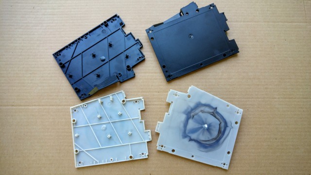

The first plastic case and metal plate samples
Our Serbian contractor has manufactured the first samples of the bottom parts of the case, the case buttons, and the metal plates.
This is the case freshly injection molded:
Right bottom UHK case in the mold
And then it’s ejected from the mold:
First test sample of the right bottom case
It’s easy to see the protruding pole-like plastic part where the case has been shot. This gets manually removed after molding.
Some more samples with the protruding part removed:

The plastic parts look pretty good for the first try, but they have some minor inaccuracies that will need to be corrected. This is nothing unexpected, and corrections like this are usual in the world of manufacturing.

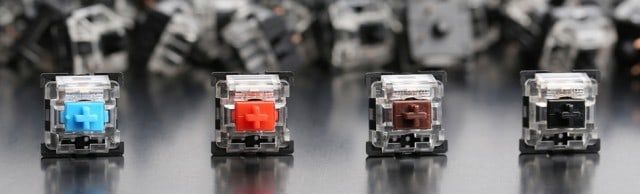

Choosing a switch brand
We have just decided which switch brand will be used for the UHK. Our campaign page mentions Gateron or Greetech as possible candidates, but in order to make the best choice we ended up considering other brands, too.
It’s important for us to share our thought process with you, so we’ll go over all the brands one by one and highlight some major points.
Cherry
Cherry MX switches
Cherry is hardly stranger to anyone, given that they’re the original designer and manufacturer of Cherry MX switches. Then their patents eventually expired, and other brands entered to the market and replicated their switches.
Cherry is the most trusted brand because they started the show, and they’re still in business after all these years, so it’d make logical sense to pick them over the others except for one thing: availability.
The supply chain issues of Cherry MX switches have been prevalent over the years. Cherry is known for striking exclusive deals with the top keyboard manufacturers of the world, much to the dismay of smaller manufacturers who weren’t able to source Cherry switches in a consistent-enough manner to manufacture their products.
Some manufacturers switched from Cherries to alternative brands, and were accused of cheaping out. We doubt that these guys were actually cheaping out. Some of them might have, but others simply wanted to get their products manufactured. We don’t want to be ever put into this situation.
Availability issues have been well known for long time, so back in the day I ended up phoning Cherry’s German sales office only to be informed that there’s nothing they can do about supply chain issues.
Given the above, we’ll only use clear and green Cherry switches because no other manufacturers create switches of such types, but for everything else we’ll use another brand.
Gateron
Gateron switches
Gateron switches are well known and loved by the keyboard enthusiast community. Gateron manufactures quality switches and trusted by many, so it’d make sense to pick them. We have two issues, though.
The first issue is the lack of direct contact with Gateron. Call us old school, but we like to get involved with manufacturers to be able to discuss any potential issues. We weren’t, however, able to reach Gateron neither across the Internet, nor via phone. We even asked a friend of ours in Hong Kong to try to get in touch with them, but he wasn’t able to.
We would much rather do business directly with a manufacturer than using a buying agent. Again, it’s not because of the slight added cost, but the ability to directly communicate with them.
The second issue is that Gaterons use milky white plastic for their housing. This shouldn’t be a problem for most keyboards because the switches underneath the keycaps are hardly visible, but it’s a different story for the UHK. When the halves are split the milky white color becomes visible, and it doesn’t gel well with the rest of the keyboard which is usually black.
Because of this, we don’t consider Gateron an ideal choice for us, and would rather pick an alternative brand.
Greetech
Greetech switches
Greetech switches resemble the look of Cherry switches the most closely. It’s very easy to miss the difference because the shape of the two seems identical. Only the text featured on the housing of the switch tells whether it’s a Cherry or a Greetech.
The Greetech switches we tested felt great. Being very similar to Cherries makes them a great choice for us, not only functionally but visually. They offer 4 MX switch types (each with or without stabilizer pins) and 2 low profile switch types.
Greetech is a great candidate, but our story doesn’t end here. We wanted to go all the way and consider every switch type.
Outemu
[/fusion_builder_column][fusion_builder_column type="1_1" background_position="left top" background_color="" border_size="" border_color="" border_style="solid" spacing="yes" background_image="" background_repeat="no-repeat" padding="" margin_top="0px" margin_bottom="0px" class="" id="" animation_type="" animation_speed="0.3" animation_direction="left" hide_on_mobile="no" center_content="no" min_height="none"]
Photo is courtesy of Massdrop
Truth to be told, we don’t know a whole lot about these switches. We can see them being used in various, mostly Chinese keyboards, but we couldn’t even find their website, and have no way of reaching them directly, so our main concern is the same as for Gateron switches.
Kailh
Initially, Kailh wasn’t on our radar because we assumed that they only strike deals with large companies and don’t serve small startups like us.
Eventually, our keycap and keyswitch supplier recommended Kail switches. He’s a guy who is also a keyboard designer, deeply passionate about keyboards, and very concerned about quality. In his opinion, Kailh switches are better than other MX compatible switch brands.
Today, I tested about 500 Kailh switches by hand and although I’m not a perfect switch testing machine, every one of them felt great and consistent. András has made a couple of blind tests and he put Cherry and Kailh into the same group 3 times in a row and put Gateron and Greetech into another group. This doesn’t necessarily mean anything, but it might mean that the feeling of Kailh switches resemble Cherry more than other brands.
There are a couple of points to be noted about Kailh. They’re a major MX switch manufacturer with more than 2,000 employees. Their manufacturing process is highly automated which should translate to great and consistent quality across their products. Their supply chain is robust and they have plenty of stock, so they can serve their customers without significant delays. Their sales channel is responsive. Kailh also manufactures automotive parts which is encouraging, because automotive manufacturers have to comply very strict quality guidelines.
Kailh’s MX switch offering is unusually rich. They offer switches of different case colors (black and transparent), optimized for regular LEDs, RGB LEDS, and SMD LEDs, and are available with or without pins.
From the innovator’s point of view, an even more interesting fact is that Kailh is not just a copycat. They recycle a significant portion of their capital into R&D, resulting in new products like the following:
Special Kailh keyswitches
Most of these keyswitches are not MX compatible but they offer various advantages over standard MX switches, like lower form factor, improved backlighting, and such, allowing developers to create new keyboards that stand out in various areas. We consider this a good thing.
Making the decision
When googling for keyswitch comparisons, one can find tons of opinions and very few facts. Some people or communities pick a brand to glorify or berate for little or no reason. We always try to be as objective as possible, and make the best choice that will result in an exceptional keyboard.
Considering all the factors, we have decided to use Kailh switches for blue, brown, red, and black, and Cherries for clear and green.
It’s important to mention that our decisions are not primarily governed by the price. There’s little difference between the price of Cherry MX compatible switches, and if we really wanted to cheap out, the first thing we’d do is to replace the super high quality Omron SS-01D microswitches of the case buttons with a cheaper part. One SS-01D switch costs about as much as 10 MX switches but the alternatives of the SS-01D have inferior durability, so we’re not willing to use those.
2018-04-28: As it turns out, Omron microswitches are reasonably priced when purchased in bulk, but they're hard to purchase in large quantities. Our PCBA contractor suggested an alternative part, the Diptronics MS2-5PN-1D(Ag) microswitch. After examining this part, we found that it represents the same high quality as the Omron SS-01D. I wanted to clarify this before being accused of cheaping out. As a general rule of thumb, we never use alternative components unless we're sure that they're of the same high quality as the parts in our BOM.
As you can see, there are a lot of factors, such as quality, availability, and aesthetics that come into play when picking a part. We think that, given the above, Kailh is an excellent choice and we’re excited to use their keyswitches in the UHK.
Should you have any opinions, you’re always welcome to let us know.

The state of the mold
The molds of the bottom cases are complete. This is the left one.
The remaining molds are also in the works, and in our true style, we’ll be posting more pictures as they get made.
