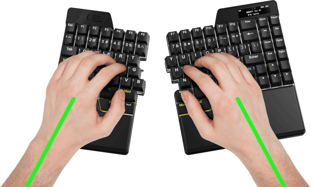

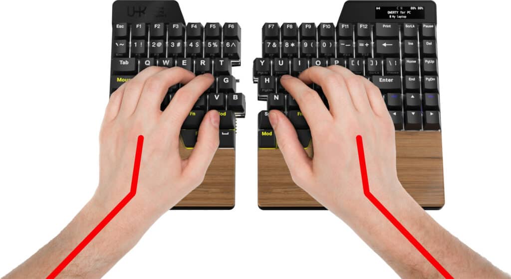

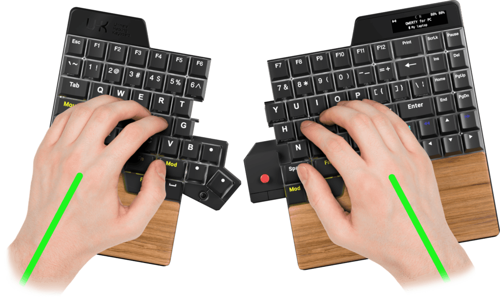

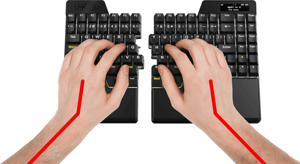

It's up to you how much space you leave between the halves, but your wrists should be aligned straight-on with each half:
Good posture
Bad posture

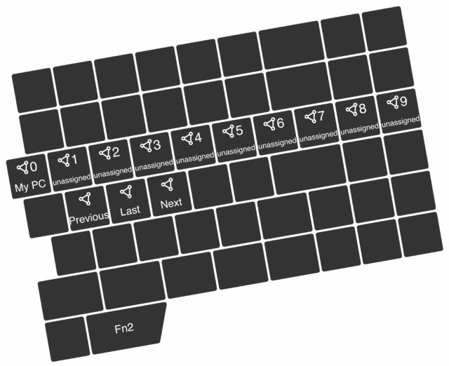

BLE (Bluetooth Low Energy): Tap a host connection key you want your device associated with. Default keys are: Fn2+U, Fn2+I, and other keys on the Fn2 layer that you'll see. Then select "UHK 80" on the host device, and enter the pairing code on your UHK. The UHK 80 uses the BLE (Bluetooth Low Energy) standard, which may not be supported on older host devices.
