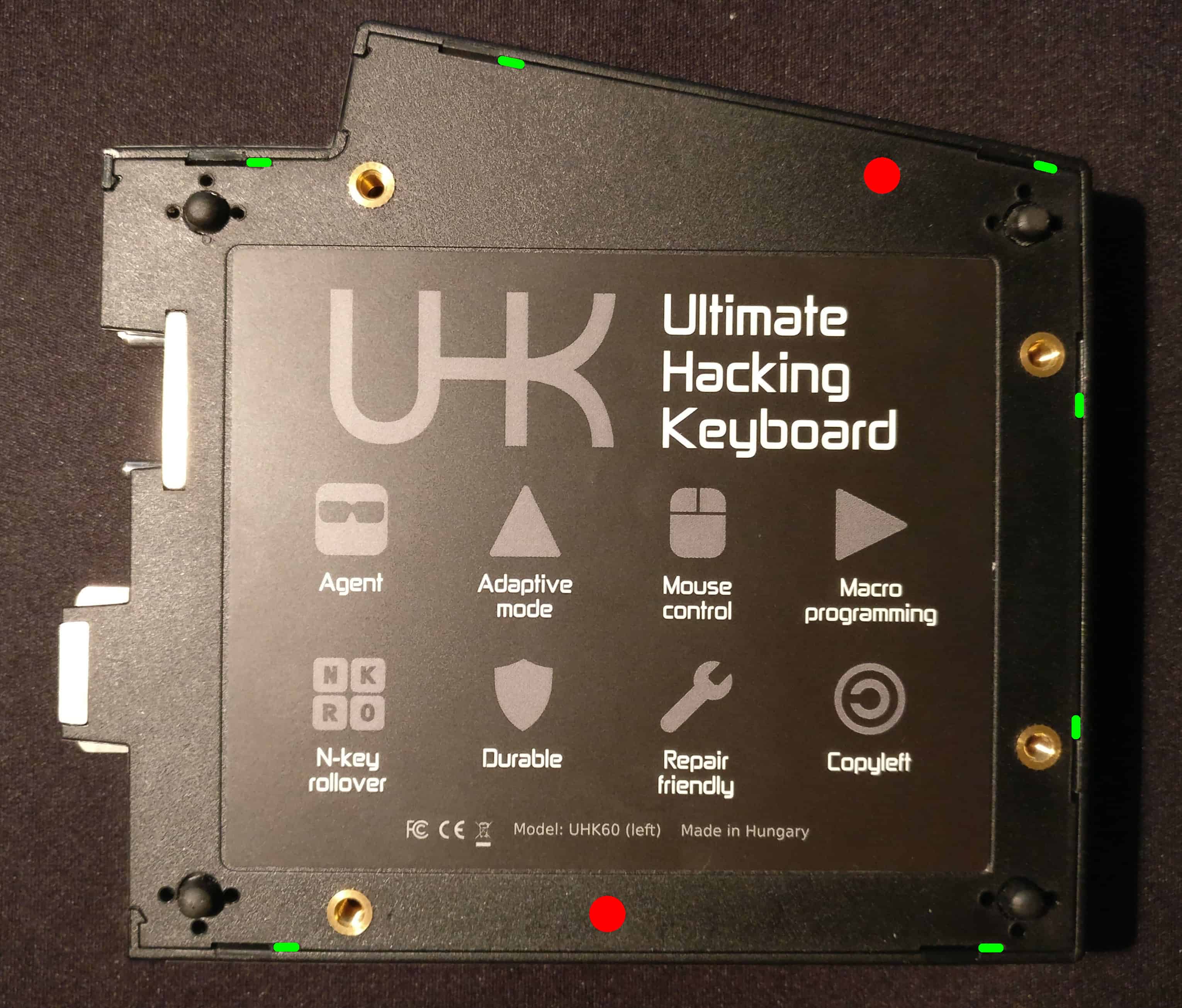

Next up, unscrew the two screws highlighted in red. Then loosen the snap-fits using a flat-headed screwdriver in the highlighted green recesses or with a prying tool. Proceed counter-clockwise starting from the left bottom snap fit on the picture.

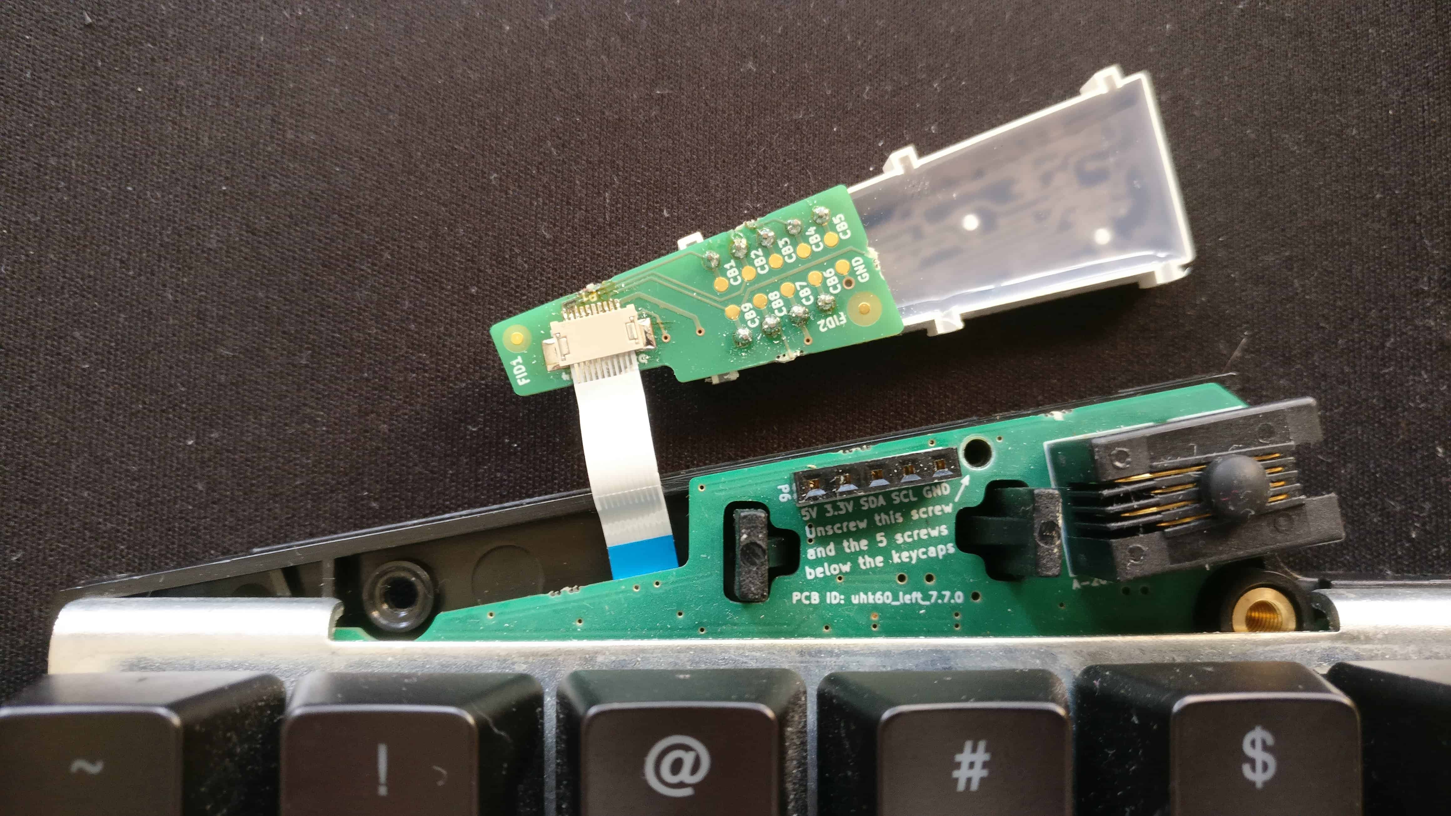

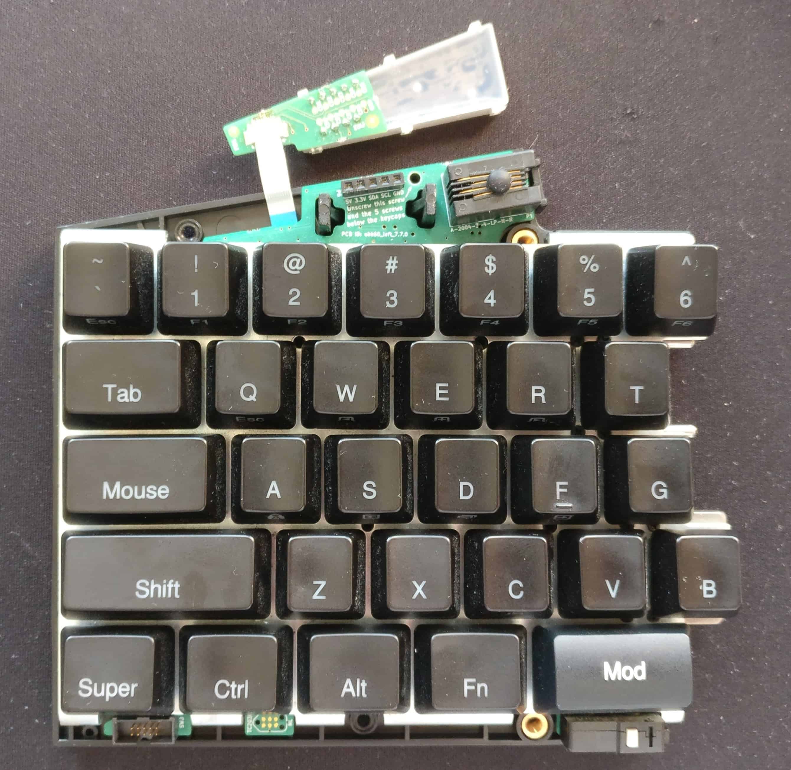

Now, you can access the FFC cable that interconnects the display and the main board.

The FFC cable has a blue plastic tag at either end that should be used to push the cable in.
Use a tweezer to grip the blue plastic tag and gently push the cable into the FFC connector on the main board and the LED display.

You can test this before assembling the case by inserting the spiral cable and cycling through the keyboard layouts using Fn +1 through to Fn + 5. Double tapping the Mouse, Mod, and Fn keys should toggle the LED indicators for those keys. If the gentle movement of the FFC cable results in spurious LED segments lighting up, you must reseat the cable again.

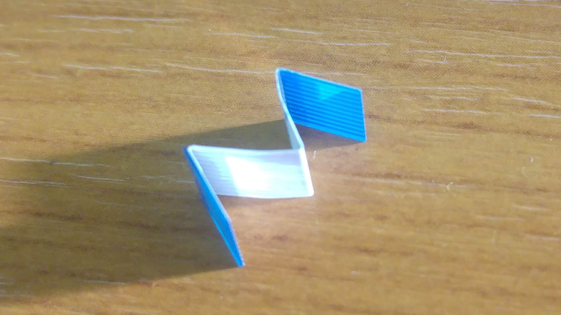

Please note that if you have a pilot-run UHK that has LED display issues, the above instructions may not be sufficient. We bent the FFC cable in an M shape to fully solve this problem. You might have to do the same. As for the orientation of the cable, the middle part of the M should point toward your UHK.
