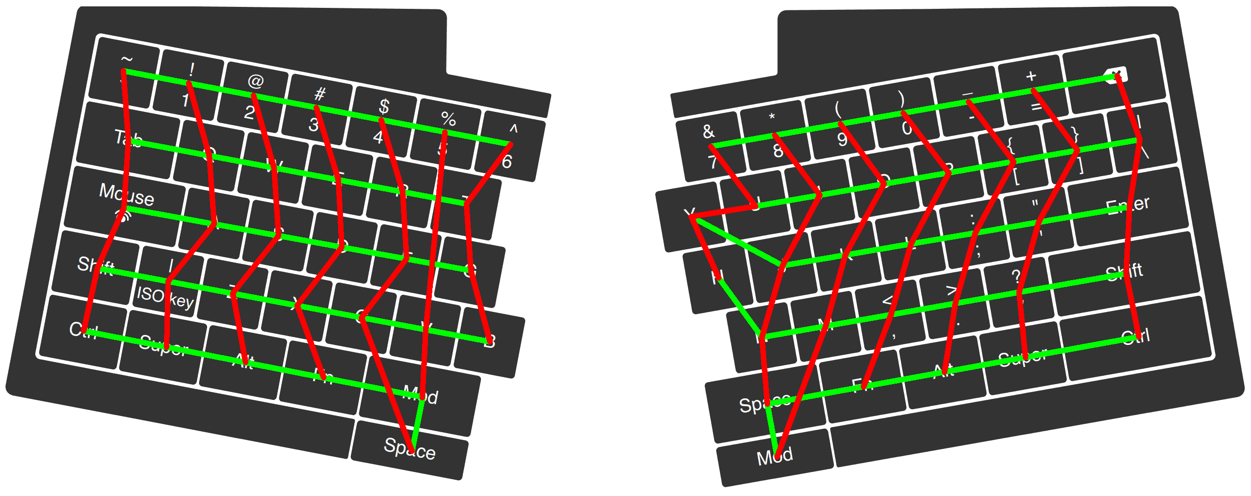

The symptoms are easy to notice as ESD damages a pin of a microcontroller that is wired to a column or, very rarely, the row of the keyboard matrix. This makes the keys of the affected columns or rows not work. The following image shows the keyboard matrix of the UHK.
The column containing the 8, I, J, N, right space keys is the most frequently affected, the 7, Y, U, H column is the second most affected, and the 5, V, left Mod column is rarely affected. Very rarely, other columns or sometimes rows are affected, but the nature of the issue is the same.

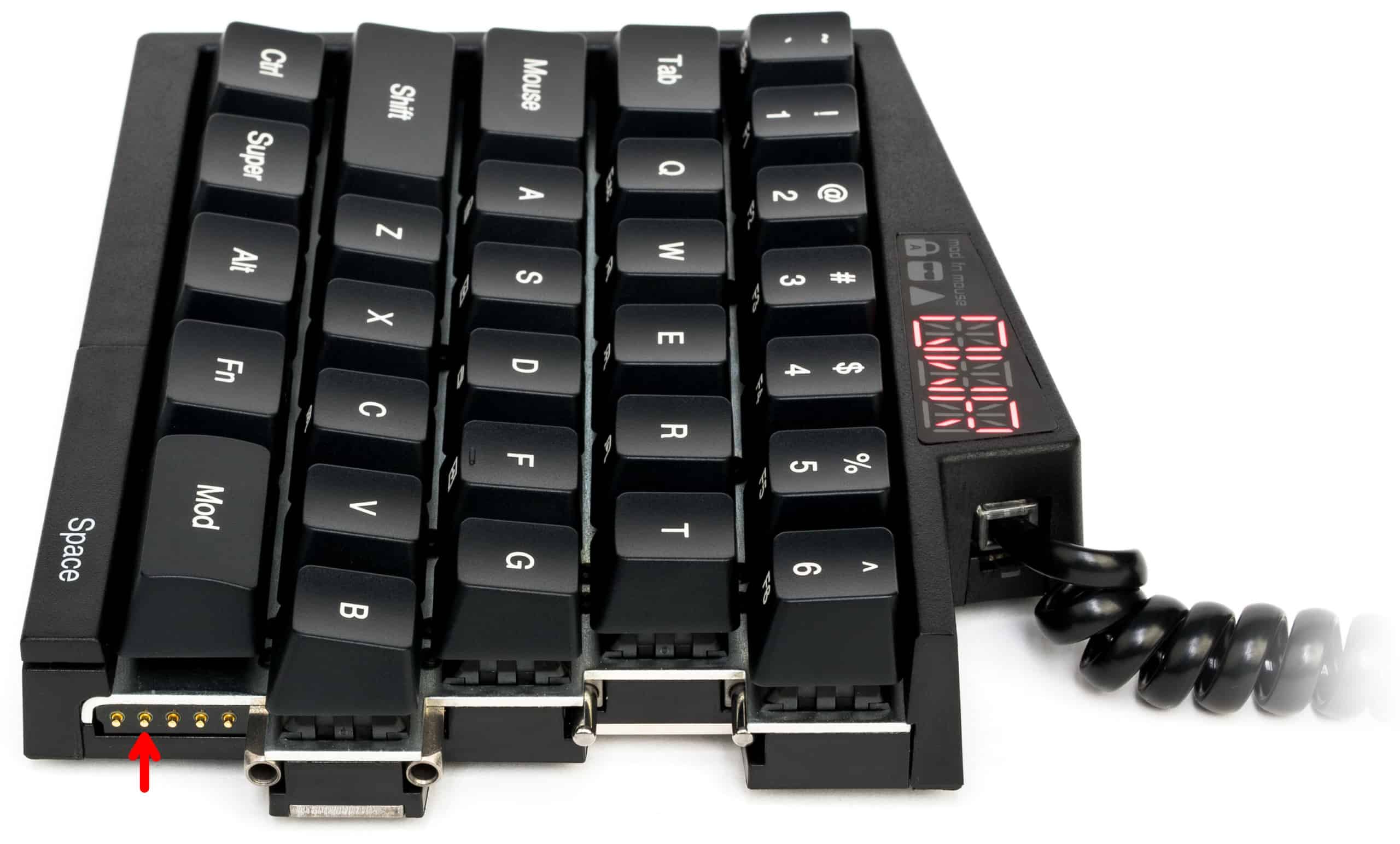

A multimeter is a surefire way to check whether your UHK is grounded. Put your multimeter into continuity test mode. When touching the two probes together, your multimeter should beep.
Now touch the left ground pin, marked by the red arrow, with a probe, and touch the left steel plate with the other probe. If the left keyboard half is grounded, you should hear a beep.

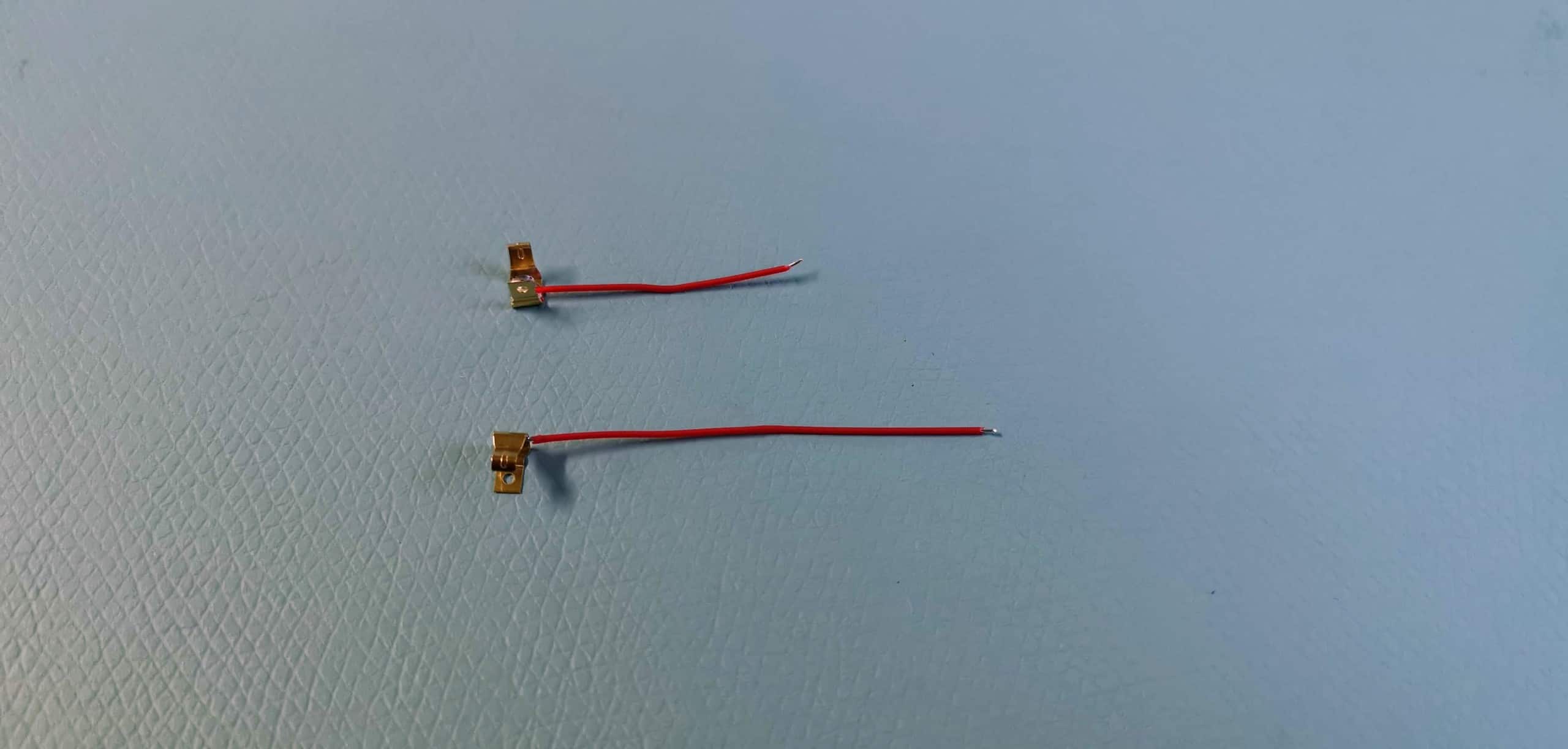

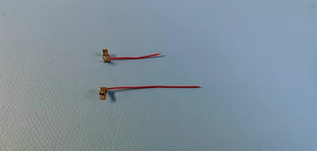

You'll need two 855-S7191-45R spring contacts and a 10 cm long wire. We use 26 AWG wire, but the diameter isn't critical as long as it's relatively thin. We use the 801-R26R wire, but its length is a tad overkill for a single repair.

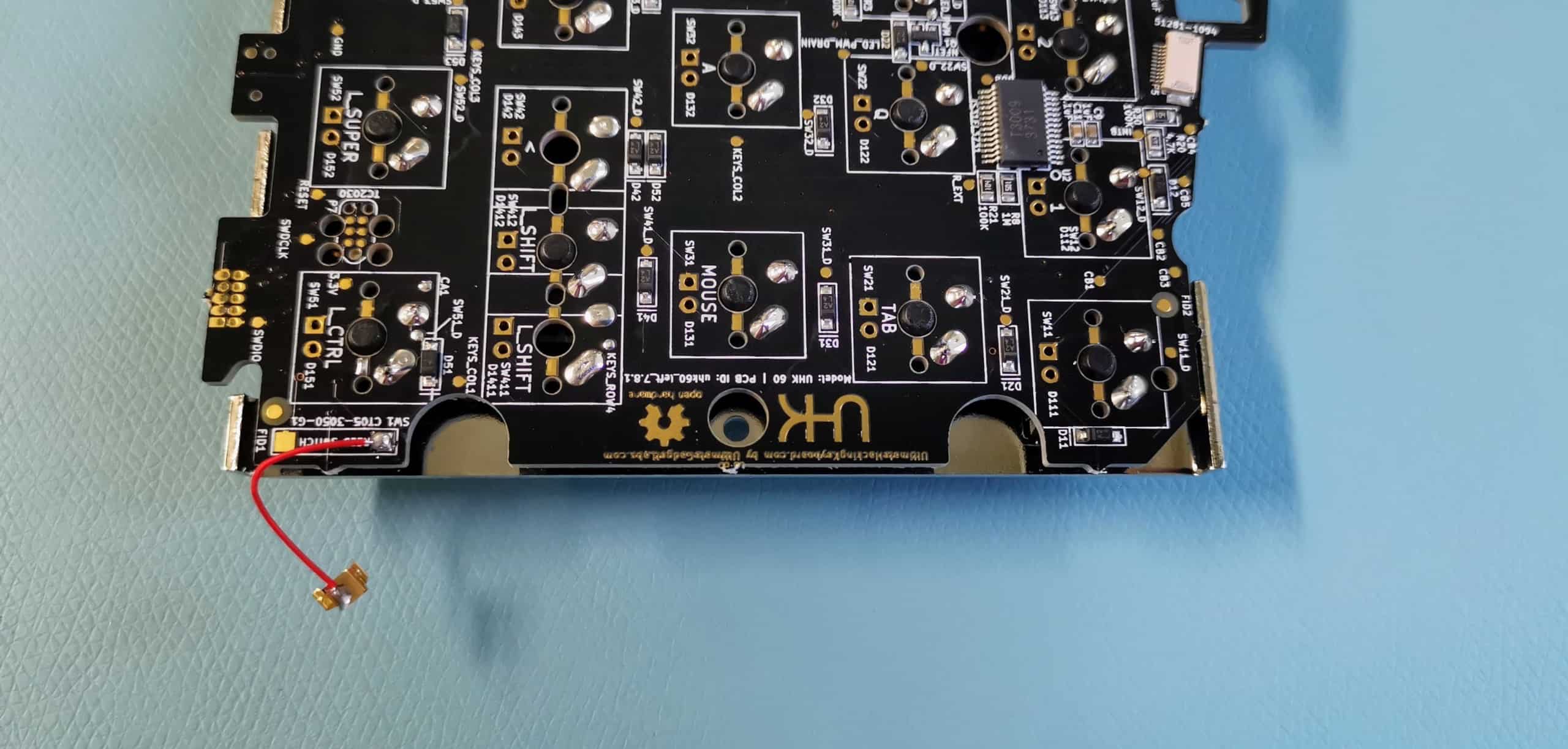

First up, you need to cut the wire to sizes. Make the left wire 27 mm long and the right wire 44 mm long. Solder the spring contacts to the ends of the wires. This is how they should look:
Next up, solder the left wire to the left PCB this way:

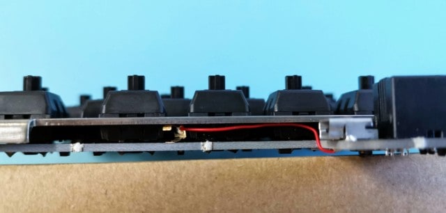

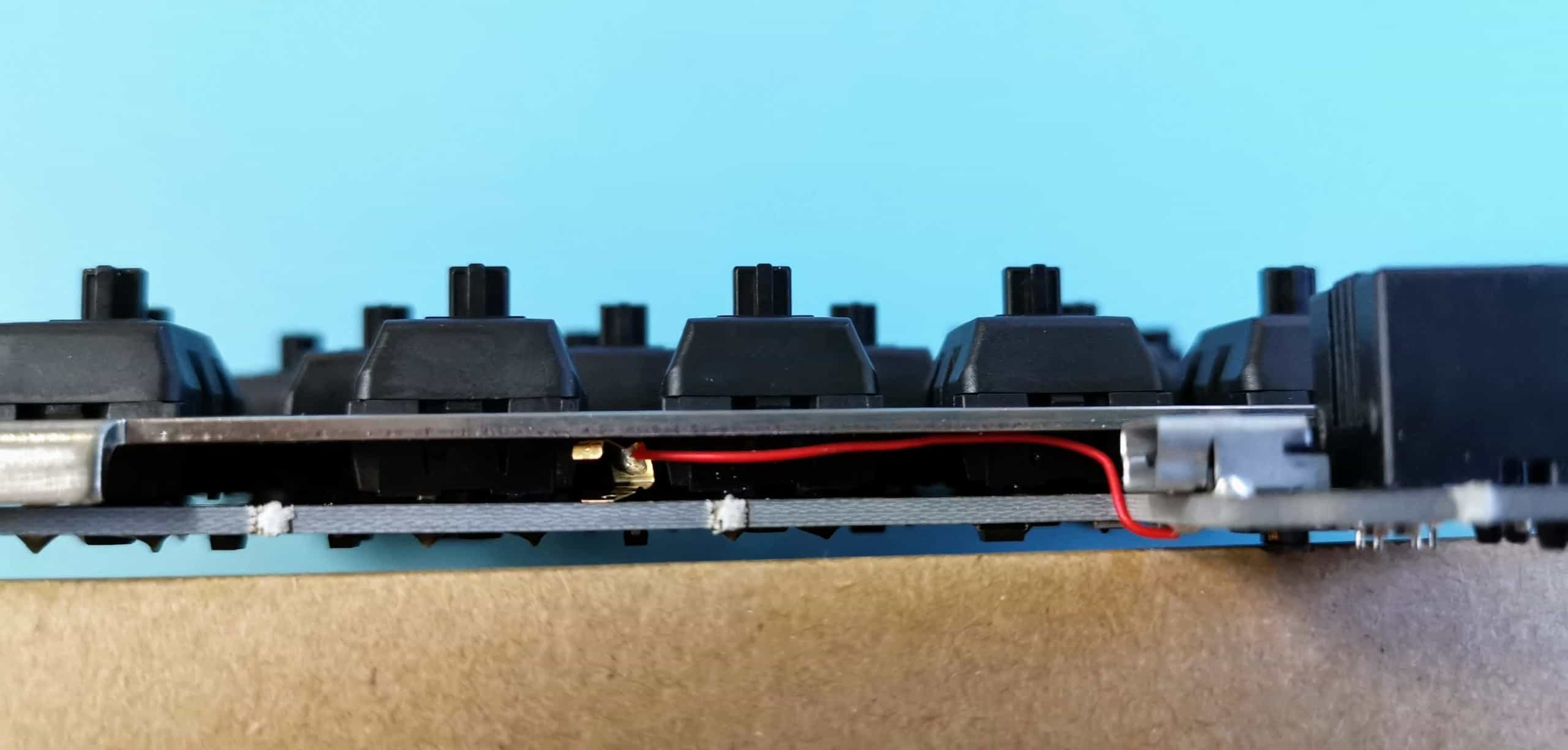

Then arrange the left wire neatly so the spring contact touches the plate:

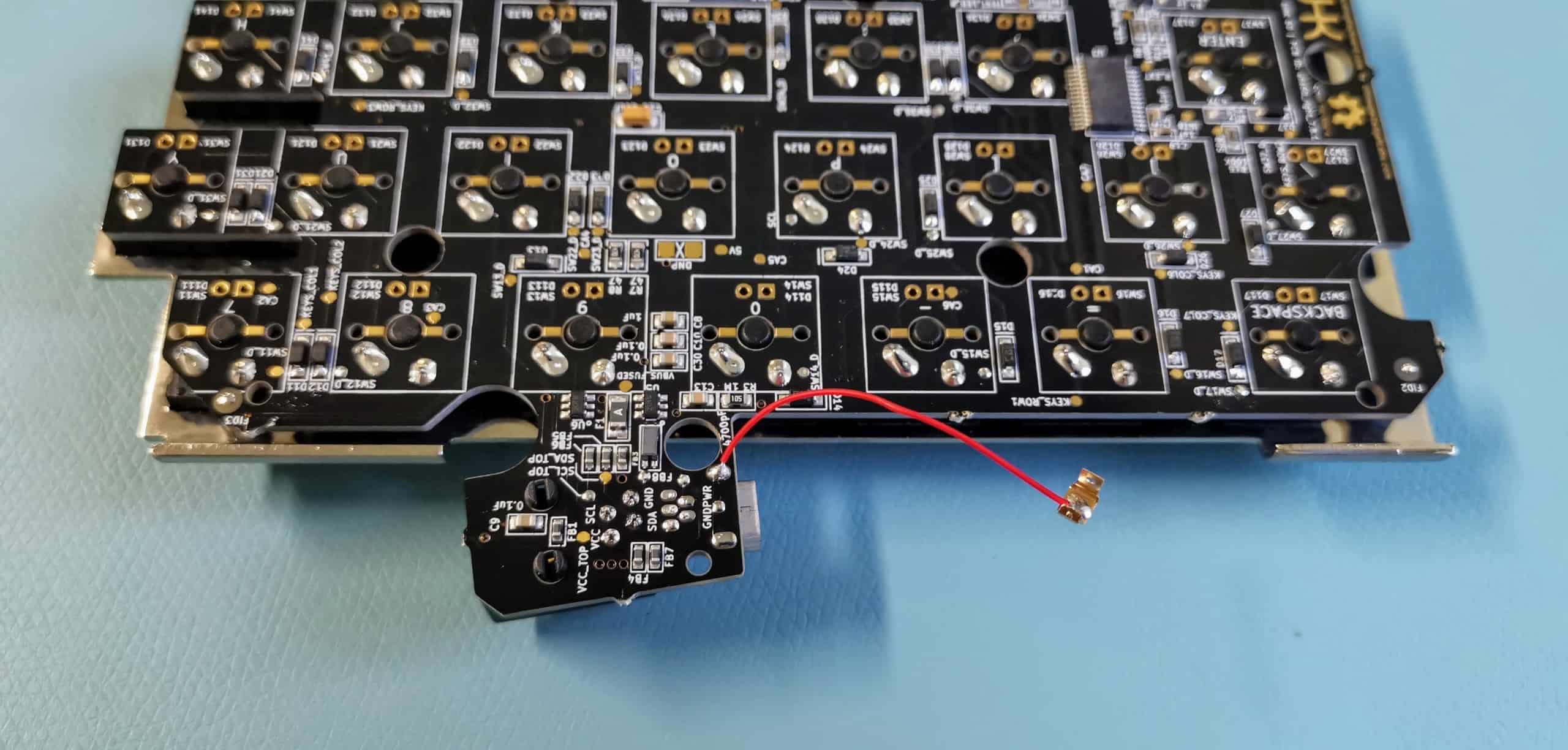

Next up, solder the right wire to the right PCB this way:

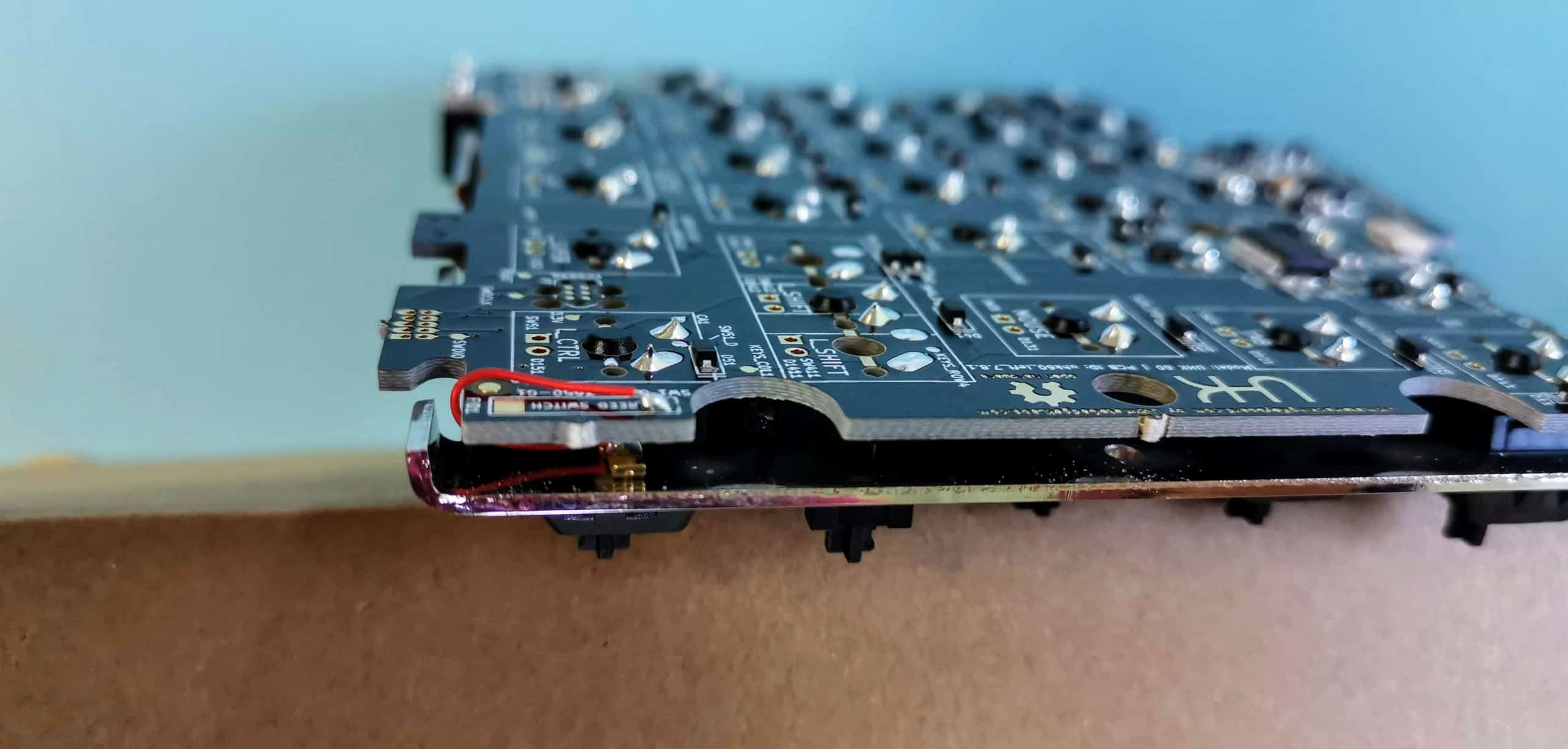

Finally, arrange the right wire neatly so the spring contact touches the plate:
